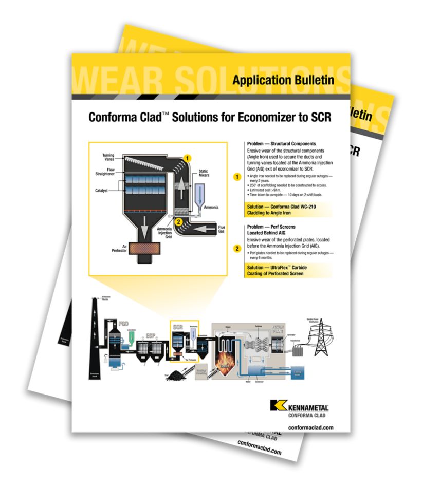

Customized Power Generation Cladding Solutions
For Power Gen customers, a number of Conforma Clad solutions can be employed to resolve multiple issues in their specific application as is outlined in our Conforma Clad™ Solutions for Economizer to SCR application bulletin.
View Application Bulletin
