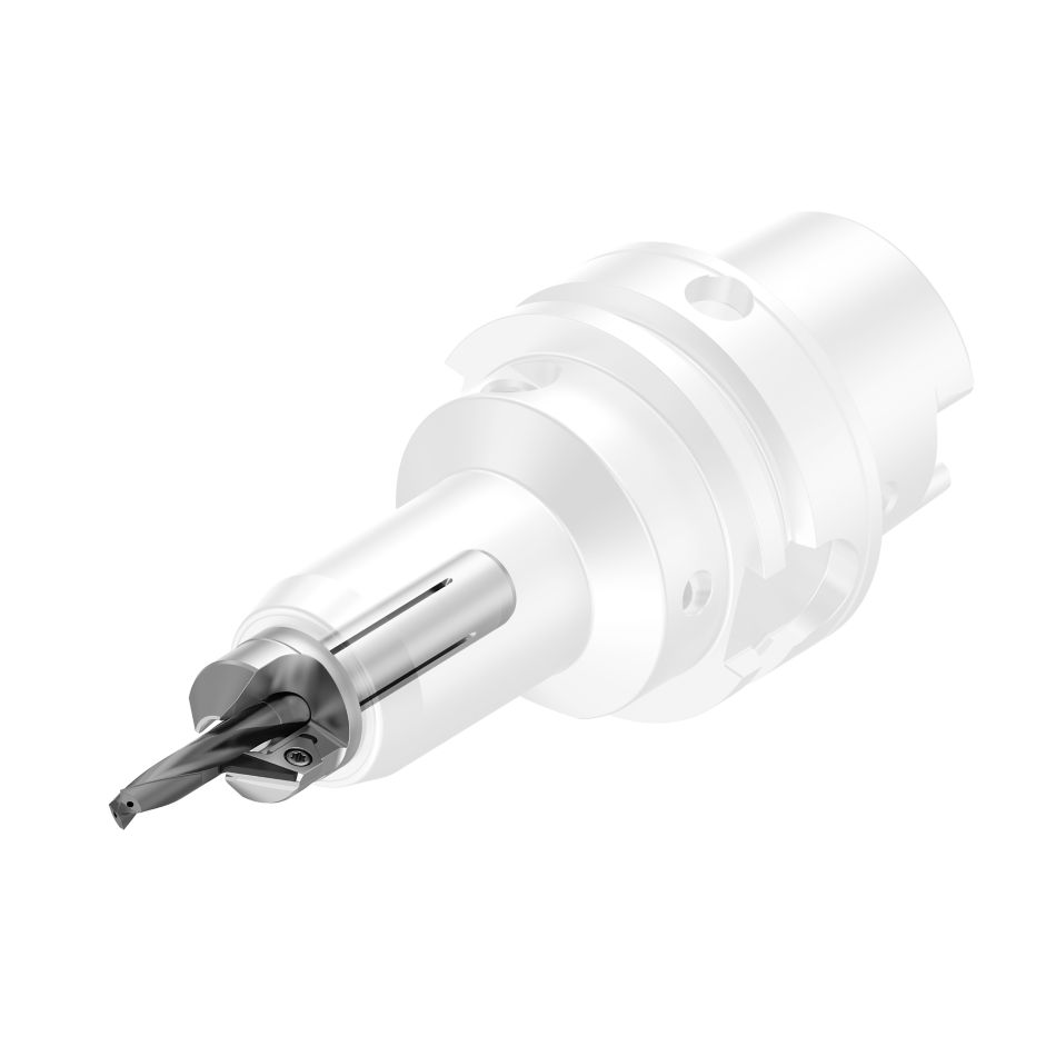

The HiPACS drilling and countersinking tool is a unique high-precision system, achieving 1-degree angular countersink tolerances in aerospace fastener hole applications.
Designed to be clamped in a standard hydraulic chuck, HiPACS consists of 3 standard off-the-shelve components:

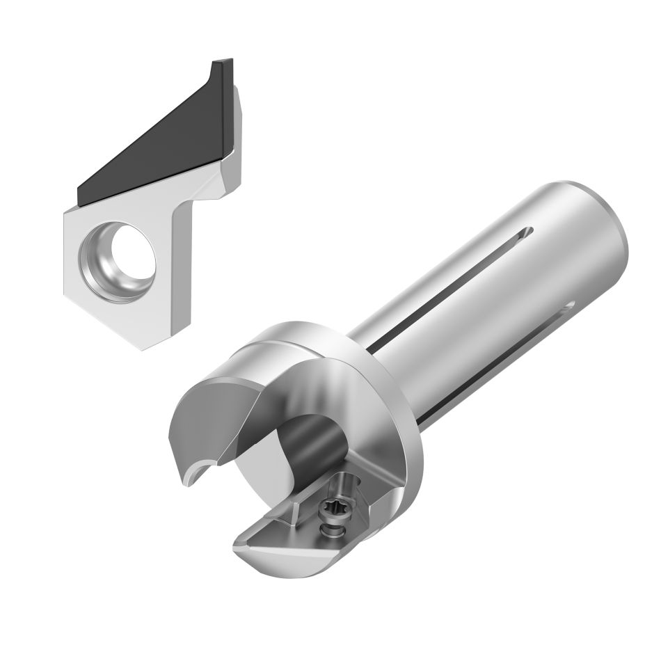

  • The HiPACS reducer sleeve, featuring a built-in high-precision pocket seat for a countersinking insert.
  • The HiPACS PCD countersinking insert

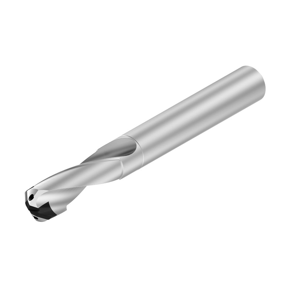

  • The HiPACS solid carbide drills with SPF and DAL point geometry.
This easy to assemble system reduces cost per hole since drill and chamfer insert can be indexed independently from another.
Replaces expensive custom solution step drill, separates tool life and cost of insert and drill.
