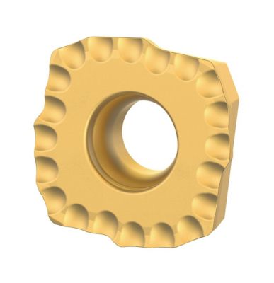

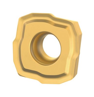

Our Drill Fix PRO indexable drilling platform comes standard with a wiper included in every outboard insert. The platform’s versatility is also elevated with four cutting edges on its inboard and outboard inserts, resulting in an extended application range that makes Drill Fix PRO incredibly cost effective. It also features larger coolant channels for higher-volume coolant flow. This innovative design element brings customers not only a strong, quiet drilling experience but also a longer tool life.
  • Cost-Effective & Versatile Indexable Drilling: Drill Fix PRO offers an economic drilling platform that covers a broad spectrum of materials and applications.
  • Robust Toolholder Design: Extreme rigidity resulting in less deviations, vibrations and noise.
  • Wiper Geometry on All Outboard Inserts: Creating superior surface finish and hole quality.
  • Optimized Coolant Delivery System: Large twin coolant channels provide enhanced coolant flow, resulting in superior chip evacuation and increased tool life.
