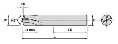

KenDrill™ Spot • 145° Spot Angle • Straight Shank • Metric
Solid Carbide NC Spot Drill
Material Number106360096
- Solid carbide spot drill for pre-centering operations, leading to improved hole positioning.
- Designed for spot drilling only, it comes with a very short flute length
- The 145° spot drill point angle protects the cutting edges of solid carbide drill lines with 140° point angle, such as the HPX, HPR, and SGL drill series.
Drilling: Convex
