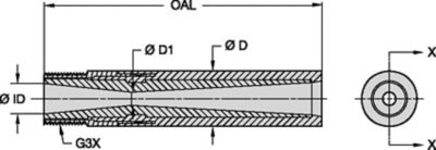

T159-P Series Blast Nozzles • Conventional Long Venturi • Tungsten Carbide • Wide Entry
Increased production over a standard venturi by eliminating restriction and turbulence upstream
  • These nozzles have a 1-1/4" entry in a flanged design, standard 1-1/4" threaded design or 50mm thread.
  • The wider throat opening in this nozzle offers a 15% increase in production over a standard venturi by eliminating restriction and turbulence upstream of the venturi section of the nozzle.
  • All of our wide throat nozzles are designed to be used with 1-1/4" I.D. blast hose.
  • Thread style: 1-1/4 – 11-1/2 N.P.S.M.
  • Polyurethane jacket.
  • Brass threads.
